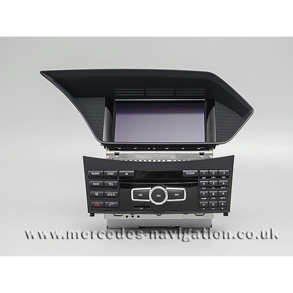

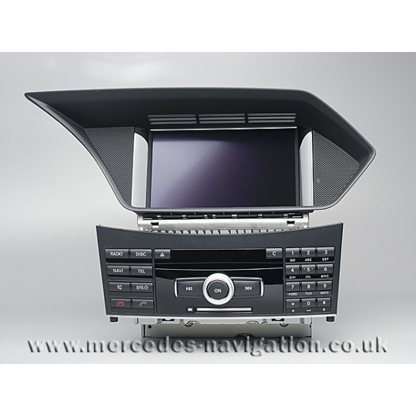

Physical differences, instead of having a SD card slot built into the HU, NTG4.0 has a PCMCIA slot:
If your HU has a SD card slot, it's either NTG4.5 or NTG4.7:

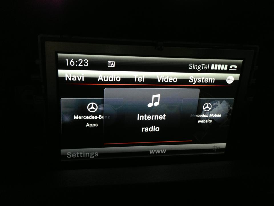

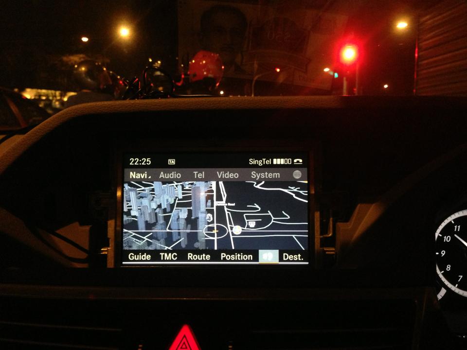

You can tell the difference between NTG4.5 and NTG4.7 by the look of the interface:
NTG4.5 (Photo courtesy of EleBest) Classic brown UI
NTG4.7 (Photo courtesy of EleBest) Sporty red UI
Do note both 4.5 and 4.7 have the globe icon on the top menu bar. It shows the system has data connectivity function, which allows you to surf the web.
