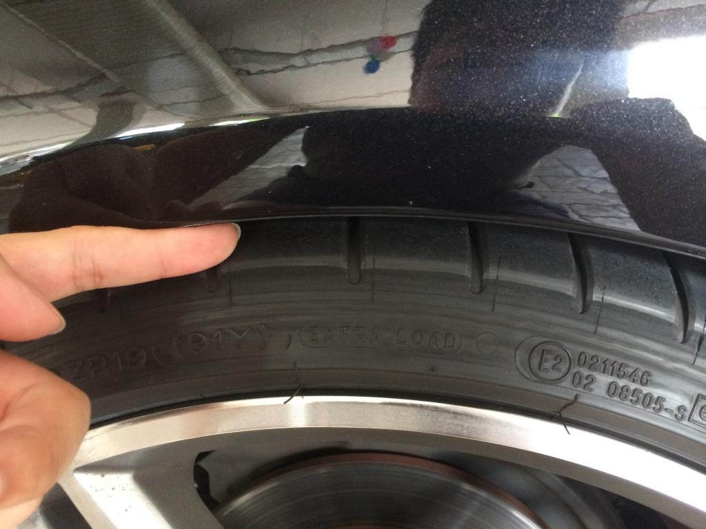

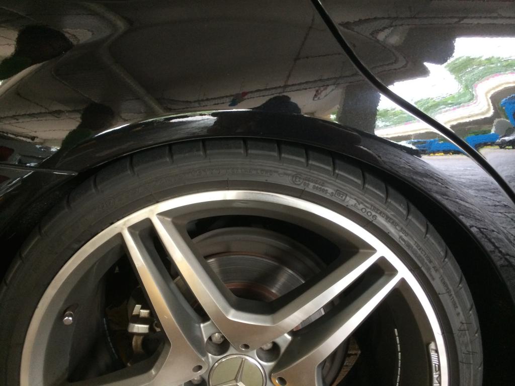

Mine use to have at least a four finger gap between the fender and rubber. Today when I send in, drop to two finger gap. When I carry rear passengers or heavy objects in the boot, the tyre rubs on the fender.
Worse case I occurred was can't even fit one finger in and I wasn't even ferrying anyone! This was about a few weeks back, had to wait for C&C's courtesy car to be available.

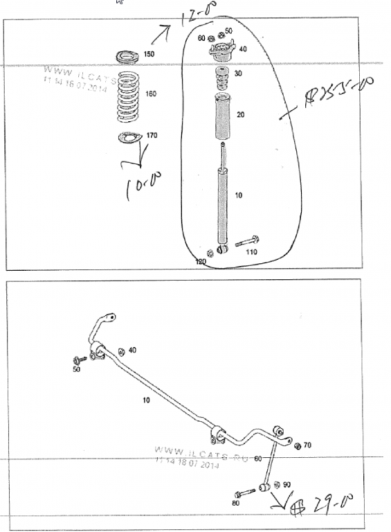

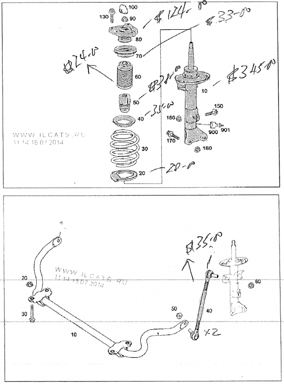

[uPDATE]
Found the stuff I need to change. See picture attached and costing.
Assuming I get Original Mercedes parts from MG.
Front - $662 each ($1324 for both)
Rear - $306 each ($612 for both)
Labour to install at Wheelpower about $300, excluding wheel alignment.
Total about $2,500. = Big hole in pocket.
But worth it cause I am keeping car for another 5 years.
