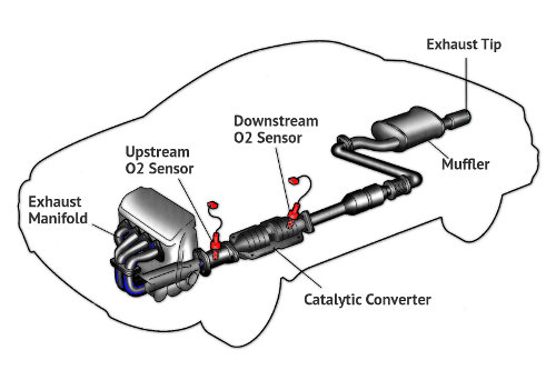

Attached image is a typical exhaust system layout of a vehicle with single exhaust tip.
What Ivan means is installing a quad exhaust system, aka having four exhaust tips. For the aftermarket quad exhaust system to be installed, the original exhaust system will have to be removed from the Catalytic Converter to the exhaust tip. It will be replaced with your new quad exhaust system. The Catalytic Converter may or may not be changed depending on which brand of after market system you decide to purchase.

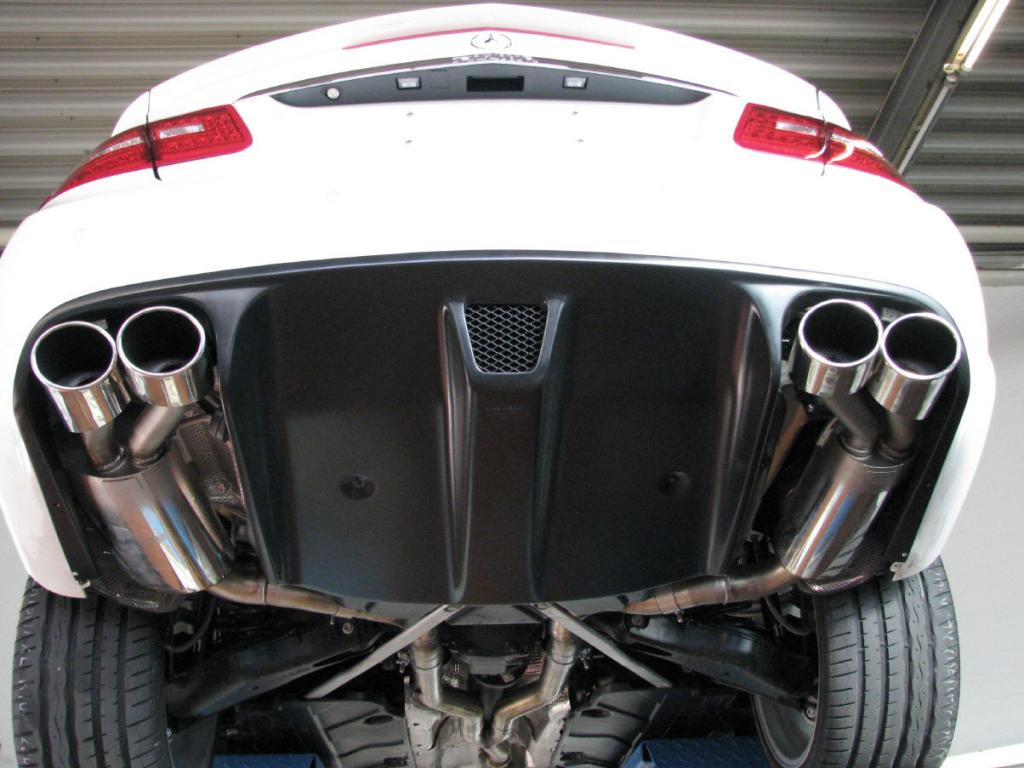

After installing, your exhaust system should look roughly like this, but of course it'll sound bassier and louder compared to the stock system. Photo is of a pre-facelift W212 E-Class but it should be the same as the facelifted 2013 model. Do note the four exhaust tips, aka quad exhaust.

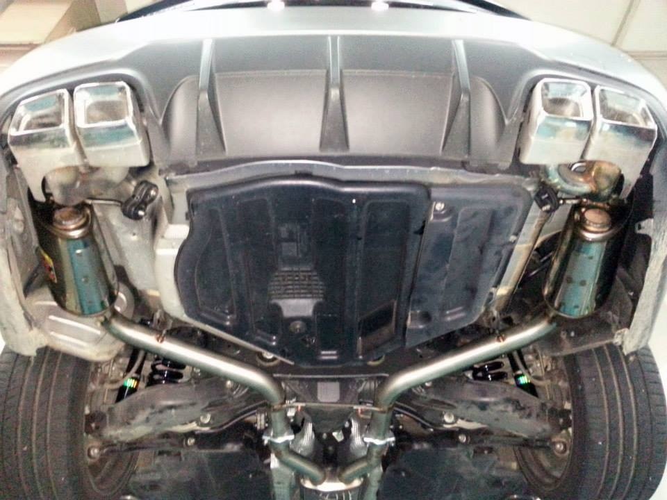

Just installed the Supersprint Catback Exhaust System.
To ensure LTA compliance, I retained my quad squared-off tailpipes without connecting to the mufflers.
Sounds pretty good!
Sounds pretty good!
