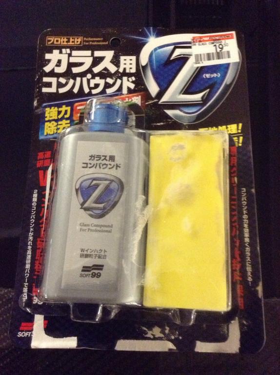

I've had experienced the same noisy wiper and tried polishing the windscreen. There are only slight improvements. Went to Autobacs and was told can't just fit in the Piaa refills. The whole thing costs $168. Bought a set of Bosch instead at $70 plus. Works magnificiently well.

So we don't really need to change the wiper? My ride is just a year 2 mths old, has the juddering sound symptoms and also some lines across the windscreen when it wipes.
Wondering if it is time to change the wiper or as you guys suggest to get the following:
1. Add the PIAA Refill in the windscreen liquid container? Is the PIAA refill better than the MB windscreen washer concentrate? or
2. Do we need to clean the windscreen using the Glass Compound as shared by bro Ray5533?
Many thanks.
