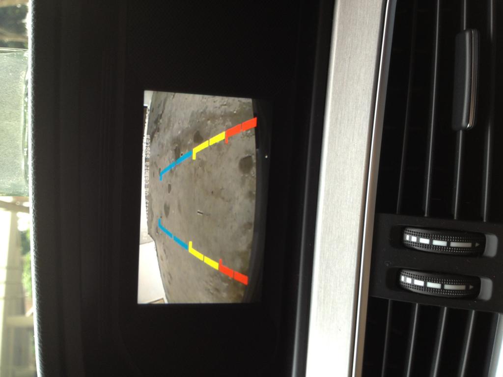

I think the factory fitted reverese camera already has some coloured lines.
But this lines seems fix (doesnt turn with steering wheel).
Hmm. Interesting, have yet to see factory fitted W204 with guide lines. Got photo of yours? For it to turn, you'll need to go aftermarket.
Tried, still cannot.
My C180 came fitted with PAL system RC to the Audio 20.
When retrofitted COMAND NTG 4.5 - which accept NTSC system.
The PAL camera has no color display & became B & W on the COMAND
Found that the RC was outsourced to Tomo-CSE by CnC.
Went Tomo-CSE asked for a change for the RC from PAL to NTSC - wasted my time there.:(
Went to AutoSpritze and traded in my PAL RC for a cheapo NTSC RC <$100 that has quide lines - Heppy! :)
