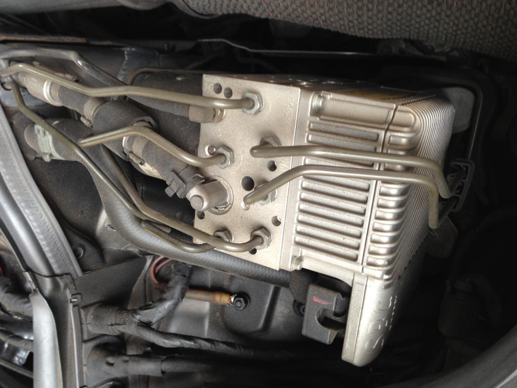

30FF7CFC-EDDD-40E3-8FE9-463E44C59A44-224
what is this? I got one of this and I have no clue what is this box?
Thanks blackmerc for your info. I am checking now, could find the brake fluid reservoir. But I notice something like that on the front and saw the brake fluid word though, without seeing the max or min level.
This is the SBC pump. Sensortronic Brake Control.... This thing cost about $2000 to replace and heard its common to break down.
Thanks Teriyaki! I went to search SBC pump and came across a previously discussed topic on this in specific model discussion.
